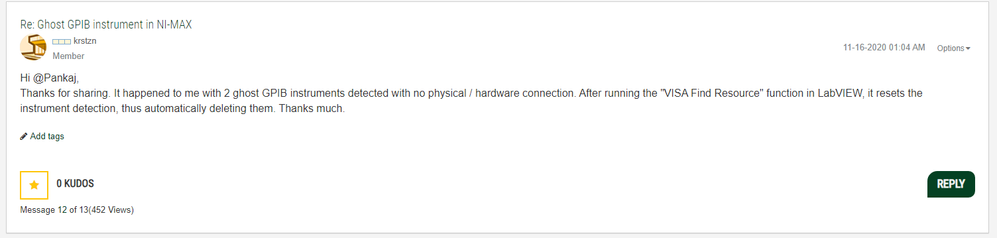

Did this method work?

If you read my explanation under the GPIB Ghost topic, you should have understood that it is not a bug.  There is actually a benefit to NOT having it automatically re-read for instruments.
Instruments that may be detached, can be simulated using the current configuration rather than creating a hardware error when hardware is not physically present.
