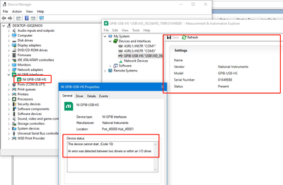

GPBI-USB-HS This device cannot start. (Code 10)
Could someone help me? Thanks a lot
I’ve installed the latest NI488.2 driver, but still got the error report:
An error was detected between two drivers or within an I/O driver
I’ve tried on several PCs and on Win11, Win10, Win7, also tried different versions of the driver, all failed. I really don’t know what’s going wrong. Yesterday I tried it on my personal laptop, surprisingly, it works, then after a while, failed again… totally don’t know why.
I tried to follow the procedure here NI Hardware Device Cannot Start (Code -10) in Device Manager, but can’t find the service named "NI Device Loader", btw, all other NI-related services status are "running"
This is the only time it worked, it showed details in NI MAX interface.
when it fails, which is mostly the case, it looks like below, a in windows Device Manager interface and little information in NI MAX interface
I would appreciate it if someone could help me out.😩

Hi  xu_feb
I see the link that you have attached can correct answer in this case. Below I am writing a path how to go "NI Device Loader",
Write Services in the Start search, Open the Services app, and find appropriate services from there to check are they running or not. Below I have attached screenshot of that window.
Also pay attention in Supported OS part  when downloading the driver.
Try to go through that article that you have attached step-by-step again.
