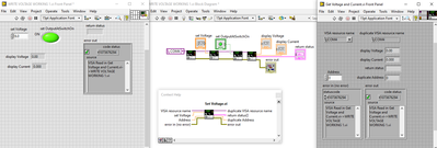

Control BK Precision 1687b power supply through VISA
See Doc & SW Tab:
https://www.bkprecision.com/products/power-supplies/1697-programmable-dc-power-supply-1-40vdc-0-5a.h...
Thank you for your help! and sharing your vi!
This bk precision 1697B programmable power supply is a cost effective solution and supports the SCPI new and old protocol meaning that the 1697 and 1697b can use the same vi's as long as you press shift than number 4 and use the dial to choose between the protocols with windows 10 automatically installed driver over usb.
