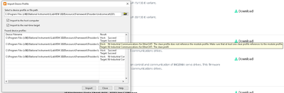

I’m trying to use a cRIO-9038 as an EtherCAT master that connects with a third-part EtherCAT slave. However, the cRIO cannot seem to discover the slave device. It seems to be this exact problem, but the solutions there haven’t worked.
The slave device is the Ingenia Jupiter 20/80 EtherCAT Servo Drive (product manual). No C Series modules are being used to interface with it. An EtherCAT cord connects the second port of the cRIO to the Jupiter board. The Jupiter board is powered up and working correctly, with all the latest firmware installed.
The LabVIEW Real-Time software is the only software used (no SoftMotion or VeriStand). NI-Industrial Communications for EtherCAT 20.0 is being used. A new project was set up according to this NI document (with special emphasis on the section titled, “Adding Third-Party EtherCAT Slaves to NI Master Controllers” because the NI 9144 was not used). XML/ESI files were downloaded from the link at the top of this download page (version 2.7.8) and imported as described in the NI document. The entire folder of XML files was imported.
Some of the files gave the following error message when they were attempted to be imported:
One of these problem files is named “DriveDict_0x10142.xml.” Since the 10142 is the slave device we’re connecting to, that could be a problem.
As stated in this document (same as the first link), the XML files have been moved to the C:\Program Files (x86)\National Instruments\LabVIEW XXX\resource\Framework\Providers\indcomecat\DD directory. LabVIEW still says it cannot find the slave device. The error message and setup is shown below:

Yes, there were a couple of steps to get it working for us...
The first step is that we had to use the "Omron compatible" ESI files. There are more Sync masters than the labview ethercat master supports in the regular ESI files.
That got us with working EtherCAT comms. To be able to drive our actuator correctly (step two) we also had to disable the CiA402 profile (Disable drive control =1) which allowed us to control the drive using SDO access which was fine for us, but may not work for you if you need to control it with CiA402 PDO type access
