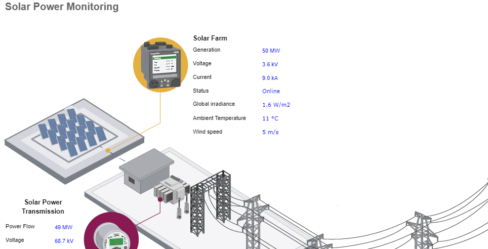

hi labviewers
first, i already create power meter monitoring but the UI looks so unacttractive,
i want to design front panel UI better than it, 2020 i think simple UI will be better looks like this
any tips / tutorial for desgin simple UI in labview ? or need some labview toolkits ? thanks
(2,045 Views)
For this type of thing, you might want to import custom images (from Photoshop, or perhaps AI generated images?) then overlay with LabVIEW controls and indicators.
