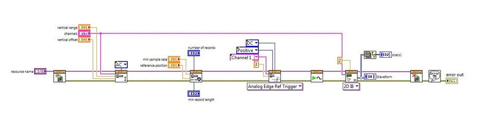

I try to follow the example niSCOPE EX Multi Record.vi and made the following vi (also attached):
Figure- Block diagram.JPGIt runs smoothly when I fetch only 1 record, but when I try to fetch 2 or more records, the following error occurs:
What's wrong with the vi or setting, and what is the more appropriate way of doing this?  Thank you~

It seems like USB 5133 does not support multi-fetch:
https://forums.ni.com/t5/High-Speed-Digitizers/StreamToDisk-with-repeated-fetching/m-p/1727894
I am looking into the streaming of the data to Labview. Any advice will be most welcome.
