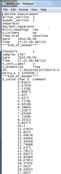

Hi Kuchean,
You mentioned that you would like the application to acquire the waveform every time it is triggered (the Configured Acquisition example does this) and hold it until the next trigger (similar to the SFP application). I may be confused by what you mean with this statement. When you say "hold it", do you mean show it on the display, or pass it somewhere to be saved or processed while new data comes in? Obviously, the display in the Configured Acquisition example will not update until new data is written to it, which means that the next trigger occurred. Is the board actually triggering each time it needs to on the correct edge? Do you instead need more insight into what to do with the data once it is fetched (such as displaying old data along with the new data on the same graph or maybe even saving the data to file or passing to a parallel loop for processing)? I am having trouble understanding what particular feature of the Configured Acquistion example that you would like to modify or add, or what current problem you are experiencing with the program.
You also mentioned the finite time out of the example program. It sounds like you will be acquiring for at least 4 seconds once the trigger occurs (500k samples @ 125kS/s = 4 seconds) so you will probably need to increase the timeout to a larger value than the default 5 seconds to ensure that you do not receive the error while waiting for a trigger and fetching all the data. If you do not know how long the time out needs to be, you can always poll the device to see if it has triggered before calling the fetch function. (Essentially, this example has this exact functionality.)
Regarding the SFP issues, you are correct that if you want to process specific data sets and implement custom algorithms, you will need to implement your own custom code. As far as saving the data and reading it back, what format are you saving in? The LVM format, for example, can be opened in Notepad and you will see a long list of data samples with some header information about the waveform (see below). There should be a few good LabVIEW examples which show how to read back the different file types into LabVIEW, and you can try them out to read the saved files from the SFP.
