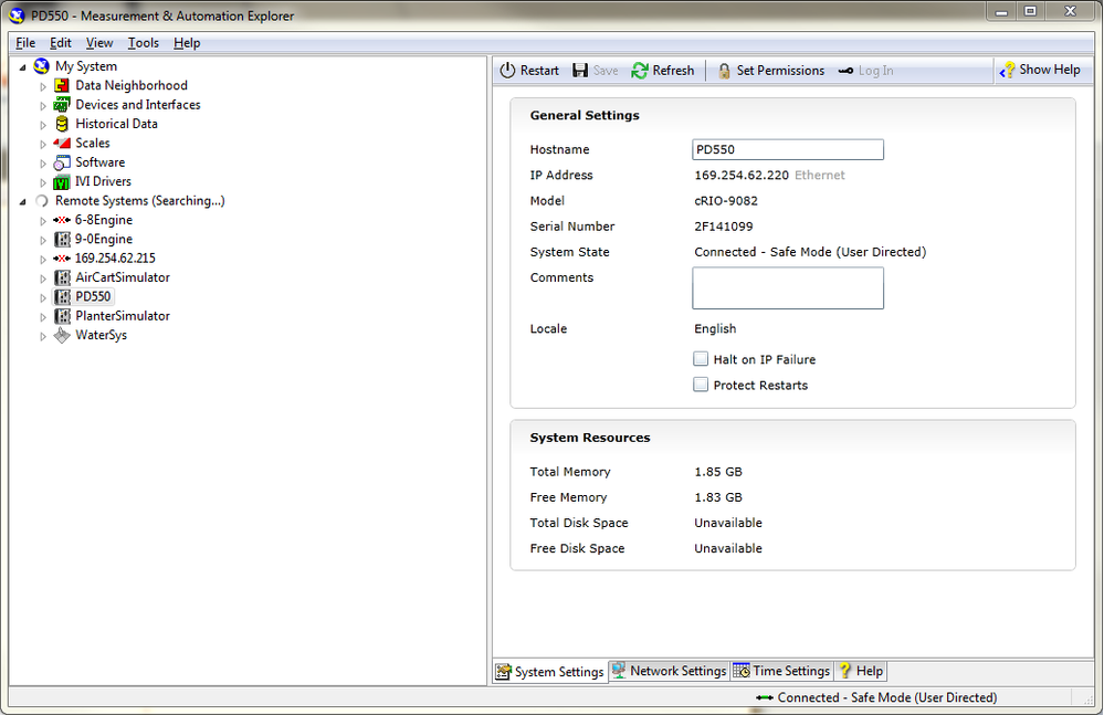

2. The 'Halt on IP' *might* not be avaliable on all RIO implementations - I just looked at a cRIO system we have setup and it's not avaliable for it.
But here is a screenshot of what it looks like in MAX. Its on the 'Systems Settings' tab not the Network settings tab [Go Figure]
