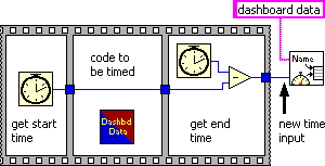

The Elapsed Times.vi can be used to measure time between calls in one or more locations of you code. In the LabVIEW Getting Started Window, the Troubleshooting the Robot tutorial explains details of how to use this VI. The Elapsed Times.vi can be found in the robot project under the Support Code folder.
You can use this VI throughout your robot code as a tool to show you how long it has been since a loop or a VI previously ran. Drop the Elapsed Times VI into a loop in your robot code or onto the block diagram of a robot code VI. Then, run your robot code, and open the Elapsed Times VI to see a list of all the locations in which you placed the VI, as well as the amount of time each part of the code takes to run. The Elapsed Times VI includes a Call Name input you can use to identify where you put the VI in your code. If you do not wire a value to this input, the Elapsed Times VI uses the name of the VI you placed it within.
Elapsed Times.vi can be edited. In the picture below (Figure X), we have added a time input to manually define the returned Delta (ms) value instead of using the last call time. This adds the capability to time specific blocks of code. While in this example we time a single VI, this could be used to time larger snippets of code as well.
