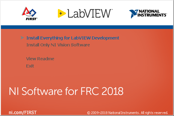

Double click on autorun.exe to launch the installer. If prompted to allow changes click Yes. To install LabVIEW to program your FRC robot, click the top option Install Everything for LabVIEW Development. To install only NI Vision Assistant for use with C++ or Java, click Install Only NI Vision Development Module.

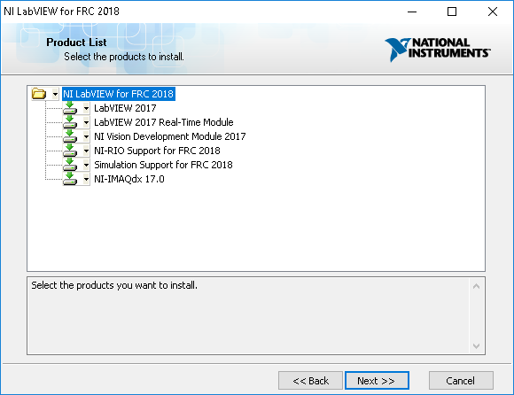

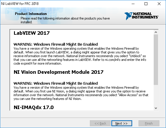

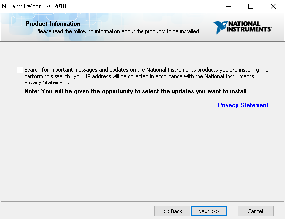

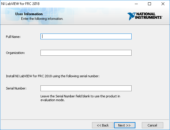

Enter name, organization, and the serial number from the LabVIEW packet in your KOP. Click "Next"8.png8.png

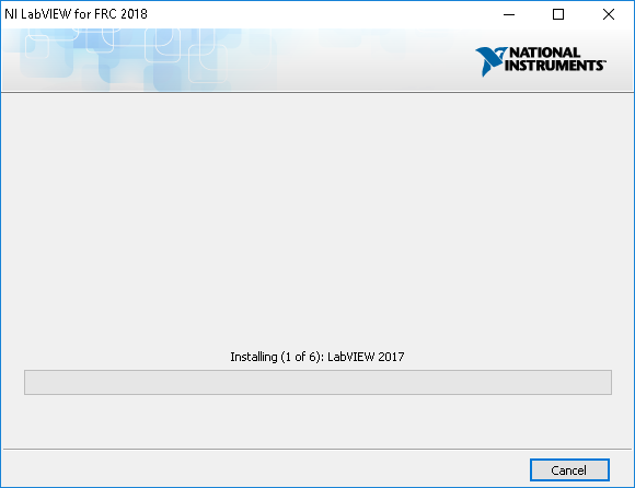

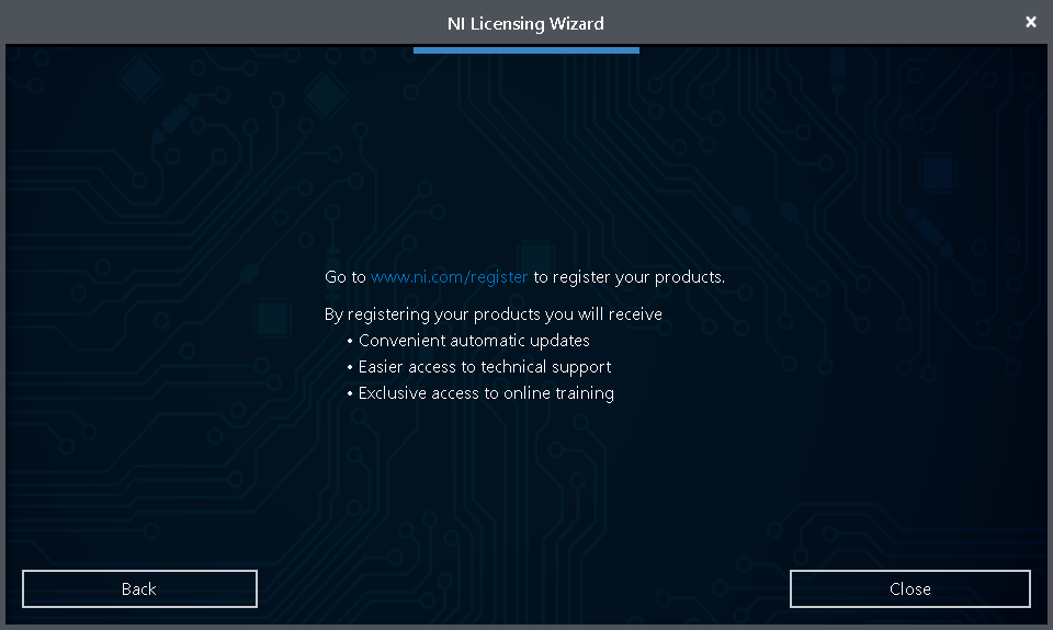

Each product installed will also create an individual progress window like the one shown above.16.png16.png
