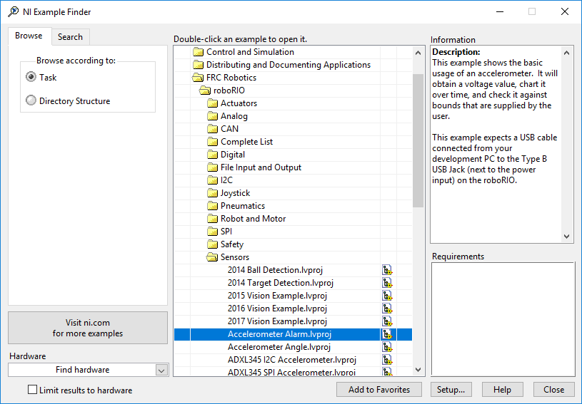

We are now ready to implement the code in the Periodic Tasks VI that reads the accelerometer. This is an excellent opportunity to take advantage of the example code installed with LabVIEW FRC. To find an accelerometer example first click View >> Getting Started Window from the menu options along the top of any VI window. Then click Support >> Find FRC Example… in the getting started window to open the NI Example Finder. Open the Accelerometer Alarm example by navigating to FRC Robotics >> roboRIO >> Sensors >> Accelerometer Alarm.lvproj and double clicking on the project name.

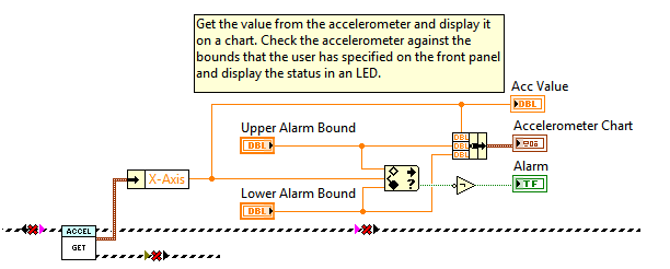

Expand the roboRIO target and open the Accelerometer Alarm VI. This VI reads acceleration from the accelerometer and compares it to an upper and lower bound. As the loop iterates repeatedly, the alarm LED will remain turned on so long as the acceleration exceeds the specified bounds. Study the block diagram of this example VI to make sure you understand the pre-written example code.
We can reuse a lot of this pre-written code to read from the accelerometer inside our Periodic Tasks VI. Click and drag to select everything inside the while loop of the Accelerometer Alarm VI except for the Wait, Unbundle by Name, Stop boolean control, and Or functions. Copy the highlighted functions seen below by selecting Edit >> Copy from the menu bar or by pressing Ctrl + C.
Paste this example code into a blank section within the block diagram of the Periodic Tasks VI. You can do this by selecting Edit >> Paste from the menu bar or by pressing Ctrl + V on the keyboard. Because you will not be viewing the front panel of this VI while operating the robot, let us make some changes to the example code:
  1. Delete the Accelerometer Chart indicator and Bundle function since you will not be viewing the front panel of this VI while operating the robot.
  1. Change the Upper Alarm Bound and Lower Alarm Bound controls to constants by right clicking on each and selecting Change to Constant.
  1. Select the code you have added to the block diagram and press Ctrl + U to automatically rearrange everything into a more compact form and delete all broken wires. You can also press Ctrl + B at any time within the block diagram of a VI to automatically remove all broken wires. Your code should now resemble this:
  1. We can retrieve the reference for our accelerometer using the Accelerometer RefNum Registry Get VI. Add this VI to the block diagram from the WPI Robotics Library >> Sensors >> Accelerometer palette. Place it beneath the Robot Drive and Joystick RefNum Registry Get functions.
  1. Earlier we created a reference for the accelerometer named “Accelerometer.” This is the name that is used to identify your accelerometer. Right-click the refnum name input terminal and create a constant with “Accelerometer” as the value.
  1. Hover your mouse over the Bundle function and then click the blue box at the bottom-center of the function. While holding the mouse button pressed, drag the mouse down to expand the Bundle function for an additional input. Now wire the AccelerometerDevRef output of the AccelerometerRefNum Registry Get VI into this new/blank input of the Bundle function. You may want to reorganize the wires to make them more legible. This section of your code should now resemble this:
  1. Hover your mouse over the grey boarder of the 100ms timed while loop. Then click the blue box in the lower right corner of the while loop and drag the mouse to expand the loop. Make it big enough for the accelerometer code to fit inside with some extra space. Select the accelerometer code and drag it into this loop.
  1. You now need to wire the accelerometer reference to the Accelerometer Get Acceleration VI. You can do this by placing an Unbundle By Name function inside the loop from the Programming >> Cluster, Class & Variant palette.
  1. Wire the pink cluster wire (coming from the Bundle function) into the Unbundle By Name function that is inside the while loop. Click on the Unbundle By Name function and select All Elements from the AccelerometerDevRef menu. Wire the output AccelerometerDevRef from the Unbundle By Name function into the AccelerometerDevRef input terminal of the AccelerometerGetAcceleration VI. Your Periodic Tasks VI should now resemble this:

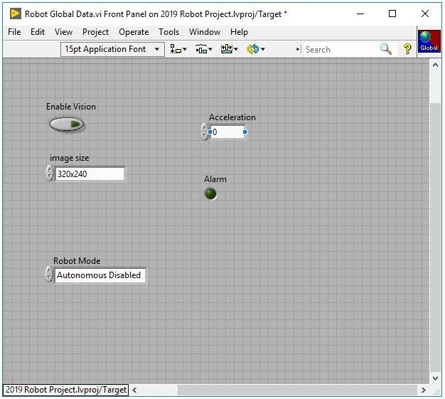

From the project explorer windows, double-click Robot Global Data.vi to open the variable editor:
You can add different front panel controls and indicators to this global variable, making them accessible to all of the VIs in the project. Add a numeric control for the acceleration by right clicking and navigating to Numeric >> Numeric Control on the functions pallet. Also add a Boolean control for the alarm by right clicking and navigating to Boolean >> Round LED on the functions pallet. Save these changes and close this VI.
Left click on the Robot Global Data.VI in the project explorer and drag it onto the block diagram of the Periodic Tasks VI. The global variable will look much like a tradition control or indicator but with an Earth icon to identify it as a global variable.FRC 2019(8).JPG
You can click on a global variable and select a specific control or indicator of the global variable to read from or write to. Click on the global variable in the block diagram of the Periodic Tasks VI and select the alarm variable that we added. Delete the original Alarm indicator we created and replace it with the global variable.
Any time you want to read or write using the variables contained in the global variable, you can drag and drop an additional copy of the global variable onto a block diagram. This is a great way to read the current acceleration value in your Periodic Tasks VI and use it in another VI. Replace the acceleration indicator we previously made with another instance of the global variable. Your while loop in the Periodic Tasks VI should now resemble this:
CAUTION: In general you can read from your global variables in several places, however you should only write to a global variable at one place in your LabVIEW project. If you write to the same global variables in multiple places, it may become impossible to predict which value is saved to that variable at any point in time. By default, a global variable is set to the Write instance. You can read from a global variable by right clicking on the variable and selecting Change to Read.
