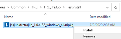

Download the latest install package attached to this post named "FRC_TrajLib-master.zip".
Select the .nipkg installation file, then double click it, or right click and select install. Administrative privileges will be needed to perform this installation. Follow the instructions. Usually selection of all the default answers is sufficient. Installation should take 5 minutes or less.
