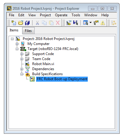

The default robot project created by the LabVIEW FRC edition contains an entry under build specifications titled "FRC Robot Boot-up Deployment" and is shown below.
This is a compiled executable version of the Robot Main VI that can be sent to the roboRIO to execute when it boots. By right clicking on this deployment you can select Build and then right click again and select Set as startup.
