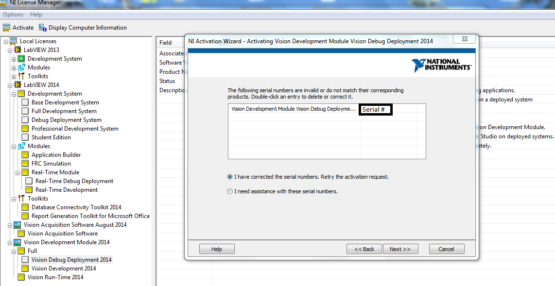

When I tried to activate the vison debug deployment portion of the vision development system it gives me an error saying something like serial number is invalid. I did double check the serial number and it is the same as what we have for the other modules.

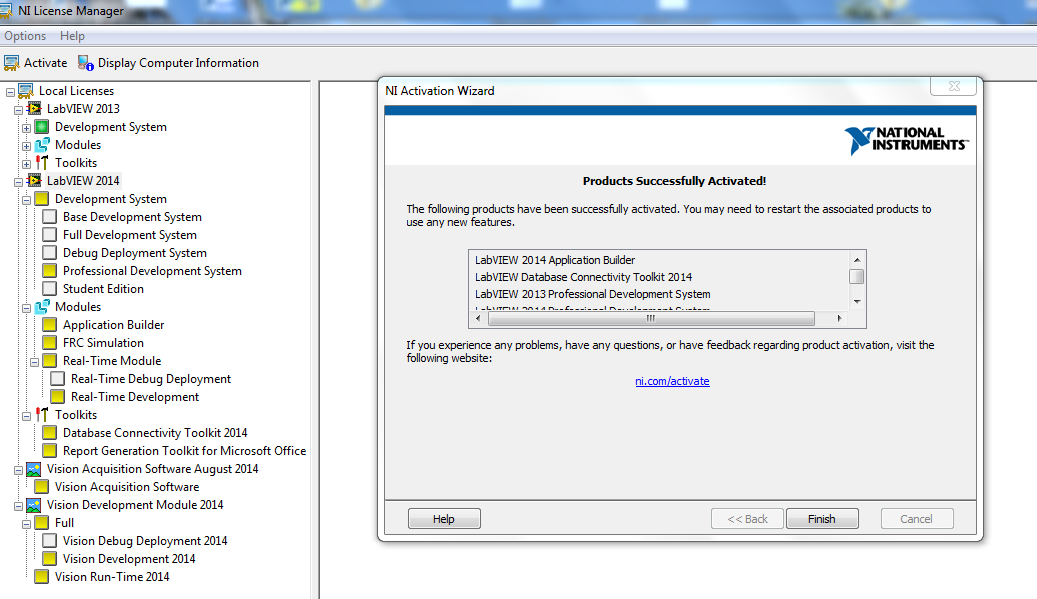

If I re-activate the full vision development component it indicates a successful activation but the vision debug deployment 2014 component says it's not activated. See the screenshot below. Is Vision Debug Deployment part of the FIRST distribution?
Here's what I get when I attempt to activate vision debug deployment by itself.

Dave,
You shouldn't need to uninstall the old software in order to get the new software to install properly.  From looking at your screenshot, it looks like none of the software is activated (not just the vision software).  That's what the yellow icon indicates.  Is the computer you are using connected to the internet while you are trying to activate?  That is a necessary part of the process.  If you plan to activate without an internet connection, you will need to call NI Support so we can give you an 20 digit activation key that will be specific to your computer.  If that is the case, the number to call is:
866-511-6285
Also, try using that serial number to activate LabVIEW, instead of just the Vision module.  See if that makes a difference.  Is your team using LabVIEW alongside the Vision module, or just the Vision module alone?  Are you using the license that came on the back of your software packaging?

OK, we resolved this problem by re-running the LabView installer. It deploys the run time code correctly now. We did not have to uninstall the LabView 2013 to do it either which allows us to program the 8-slot chassis too.
FYI, the yellow boxes just indicate that the component is activated but on an expiring license basis. Our activation is good until Jan 15, 2016.
