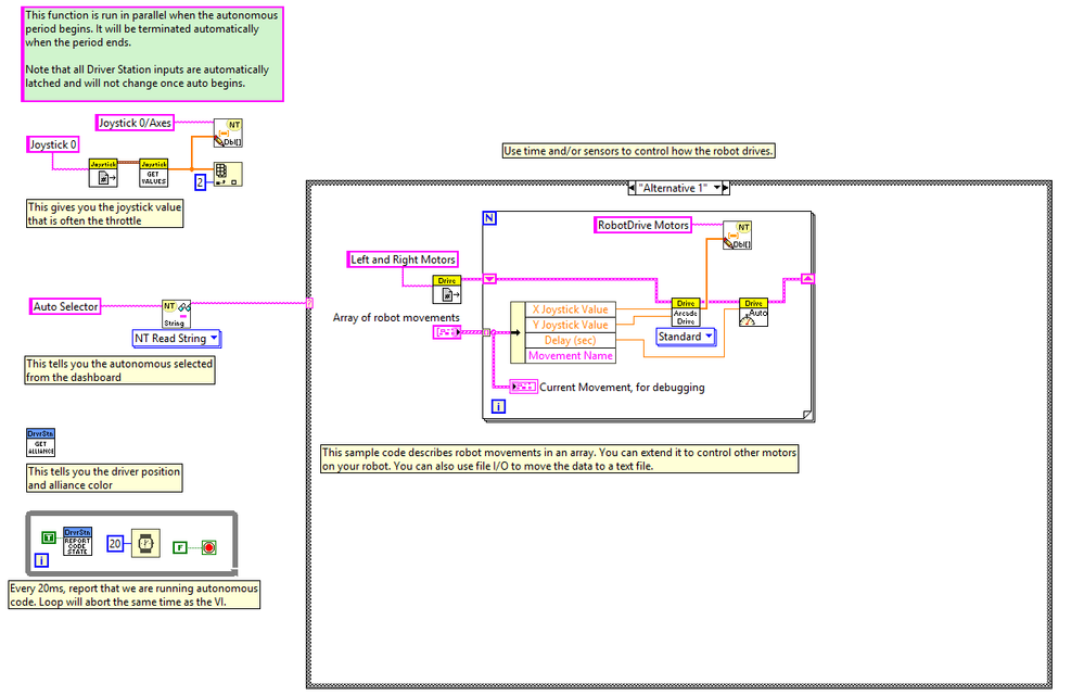

The autonomous timed movement tutorial starts by examining the example VI provided in LabVIEW and then providing insight into implementing this mode for the robot project.
We begin by going over the example VI that shows two methods of implementing autonomous movement. Before we look at the two different methods, we see the left side of the block diagram which sets the stage for the program. The code here determines the type of movement to execute and also provides information being used as references or as debugging tools to monitor the functionality of the VI.
This includes
  • Initializing the joystick and giving the joystick value (which is often used as the throttle)
  • Configuring movement pattern by reading in what is selected. In this case, the autonomous control was selected from the dashboard
  • Showing the driver position and the alliance color
  • Confirmation that this autonomous VI is running
Figure 1. Autonomous Movement Tutorial Example: Alternative
Based on the selected moving pattern- the case structure presents two types of movement control. The first alternative uses a For loop to run an array of desired robot movements. The robot will move in the pattern based on the elements in the array. This allows for easier integration with large amounts of movement and outputs current movement for debugging.
The second alternative is a much simpler movement that curves in one direction and then the other. By using the Drive VIs, the robot is instructed step by step to turn in both directions for a certain amount of time. This is a great way to implement simple movement, but is less effective if you have long sequence of motions.
Figure 2. Autonomous Movement Tutorial Example: Alternative 2
This example is just the starting point for configuring an autonomous movement. In the previous years’ documents and in the next section of this tutorial, we discuss modularizing the movements by creating subVIs that combines repeating operations of movement into one entity.
