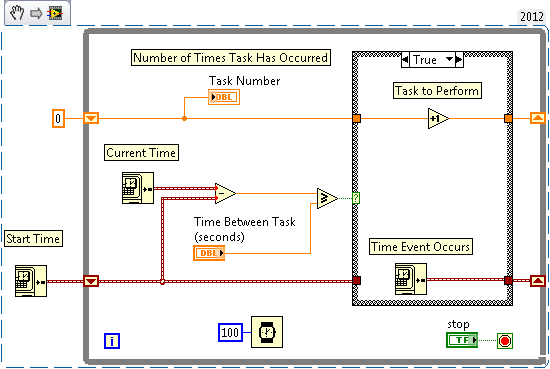

This example performs a task for a set interval.
Description
This technique can be used to repeat any type of task including saving a file every hour or changing an indicator every minute.  This example also allows for other tasks to occur at shorter intervals within the while loop. The while loop will continue to run at the speed dictated by the loop timing.
Requirements
  • LabVIEW 2012 (or compatible)
  1. Download vi
  2. Set the time interval
  3. Place the code for the task that you want to execute inside the case
