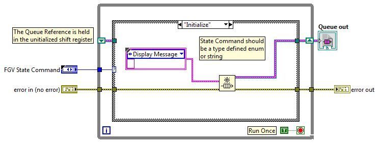

This example shows how to keep queue references in an FGV, which can then be used in a Producer and Consumer design pattern.
Description
FGVs make use of uninitialized shift registers to hold data between each call. The FGV is implemented to receive 3 commands, namely initialize, get and release. "Initialize" is used at the start of the program to obtain the desired queue reference, "get" is used to obtain the queue reference at any part of the code after it has been initialized, and "release" is used at the end of the program to release the queue reference.
The FGV is also implemented in a Producer and Consumer design pattern to clearly show how this can be utilized.

  1. Run the main vi, and press the "Do something" button.
  2. Note that the "Do something" message is being handled by the consumer loop.
  3. Press the "Stop button" to exit the program.
  4. Open up the "Queue Access FGV.vi" to study how it is implemented and note that there queue references are initialized and extracted from the same FGV.
Main vi block diagram
Queue Access FGV block diagram

I would recommend adding a Send Message case.  That way those who are sending the commands done have to get the reference and then enqueue the element.  They just call this VI to send the command.

Hey crossrulz,
I left the send message case off the FGV in case of a fixed queue size. Because this VI is non-reentrant, if you attempt to enqueue a message to a full queue, you could run into a deadlock if you have a non-zero timeout. If you abstract the send message case one level higher to individual message APIs, you can avoid this issue.

If you get deadlock, then you have more issues.  Only one place should be reading from the queue.  so what you do is Create the queue and then pass the reference into your reading loop.  That loop then doesn't care about this VI.  Only those sending will need it.  So you shouldn't have any deadlock.
Call the Close case after the reading loop is complete.

The problem is that the queue reference also has to contain the type of data in the queue.  You can copy the queue reference and paste is where ever you need it.
