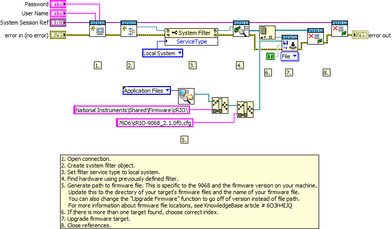

This example demonstrates how to programmatically install firmware on a Compact RIO target.
Description
This code demonstrates programmatically upgrading the firmware on your cRIO using the System Configuration API. Checking and upgrading firmware versions can be very important on NI Linux RT targets, escpecially if you're also programmatically upgrading system images.

  1. Download and open the attached file "Install Firmware on cRIO LV2012 NIVerified.vi"
  2. Open VI and follow the instructions in Front Panel and Block Diagram and run the program.
Install Firmware on cRIO LV2012 NIVerified.vi - Front Panel.pngInstall Firmware on cRIO LV2012 NIVerified.vi - Front Panel.png
Install Firmware on cRIO LV2012 NIVerified.vi - Block Diagram.pngInstall Firmware on cRIO LV2012 NIVerified.vi - Block Diagram.png
