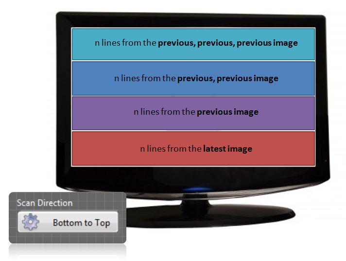

In essence, this application extracts n lines from the previous n images. These extracted lines are then used to construct the weird and wonderful slitscan image.

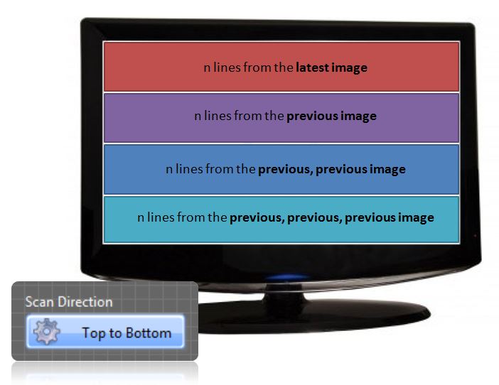

The application also include a button on the front panel that allows you to reverse the direction of the scan.Scanning (bottom to top).JPG
To achieve this, the attached code creates a continuously updated cyclic buffer, which contains a certain number of previous frames from the live video stream. The specific number of frames that are held in memory are determined by the...
