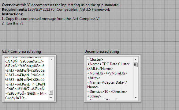

This example's functions will compress and decompress a LabVIEW string using the .NET framework.
Description
The inputs and outputs are strings, there is no file I/O involved. Applications include large strings transfer over slow connections or storing large strings (XML) in a database BLOB.

For the decompression VI
1. Call the constructor of the MemoryStream Class located in mscorlib 2.0.0.0 >> System.IO >> MemoryStream to create a stream whose backing store is memory
2. Call the constructor of GZipStream Class that provides methods and properties used to compress and decompress streams in Decompress mode
3. Use the GZipStream Invoke methods to read the decompressed data

5. Open the VI "dotNET Decompress String"
6. Paste the compressed string in GZIP Compressed String
7. Run the VI and note the decompressed string

It seems that the GZIP isn't working with dotnet 4.0.
I have installed Labview 2014 SP 1 with dotnet 4.0 and in the decompressing VI it get this Error:
Invoke Node System.Reflection.TargetInvocationException: Ein Aufrufziel hat einen Ausnahmefehler verursacht.
          Inner Exception: System.InvalidOperationException: Das Lesen aus dem Komprimierungsstrom wird nicht unterstützt. <append><b>System.InvalidOperationException</b> in Global_Library.lvlib:gZip Decompress String.vi
Does anyone have a Solution for this Error?
Solved:
With the LV2014 VI's it works!!

The Decompress process doesn't work with LV2014.
The Error is: code 1172
source:
(A call aim has caused a special mistake.)
    Inner Exception: System.InvalidOperationException: Das Lesen aus dem Komprimierungsstrom wird nicht unterstützt. <append><b>System.InvalidOperationException</b> in dotNET Decompress String.vi->test.vi
(The reading from the compression stream is not supported.)

If you are having a problem with .NET 4.0, please see this forum entry. At the bottom is a DLL wrapper than can help with decompress.
There is an CAR (#493662) for this problem.
http://forums.ni.com/t5/LabVIEW/Weird-behaviour-with-NET-constructor-node-and-GZipStream/m-p/2900906...

A long standing bug created based on a change in the .NET gzip functionality caused the decompress function to fail.
There are other posts on the NI forums that add a fix by using an intermediate DLL.
Based on a post on the LAVAG forums, the bug can be overcome using .NET reflection. https://lavag.org/topic/20613-net-decompression-gzip-or-deflate/
The example on LAVAG assumes that the user is using files to compress and uncompress. I adapted the .NET reflection functionality to use a MemoryStream and allow the Decompress function to work without the need for an external DLL.
See the attached decompress V2 file
