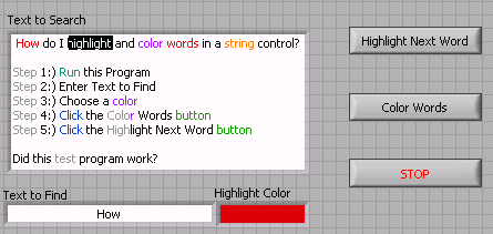

This example demonstrates how to search, find, highlight, and color characters or words in a string control. An event structure monitors the front panel controls buttons.
Description
When you press the Highlight Next Word button, the VI searches for a space in the string control to determine when a word starts and ends. The VI highlights the word that occurs before the space. The shift register stores the position of the last highlighted word.
When you press the Color Words button, the VI searches for the text you specifiy and colors all instances of that string with the color you specify.
The Searching Algorithm SubVI uses the Match Pattern function to find an instance of the string in the Text to Search textbox. The top level VI uses the Searching Algorithm VI in a While Loop to build the location of each matching pattern into an array. Finally, the top level VI uses an indexed for loop to read one value from the array at a time and  change those values using a property node before displaying the  resulting text in the Highlighted Text indicator.

  1. Run the VI
  2. Press "Highlight Next Word" to highlight the next word
  3. Type a search term in "Text to Find"
  4. Select a "Highlight Color"
  5. Press "Color Words" to search for the search term and color the corresponding words
