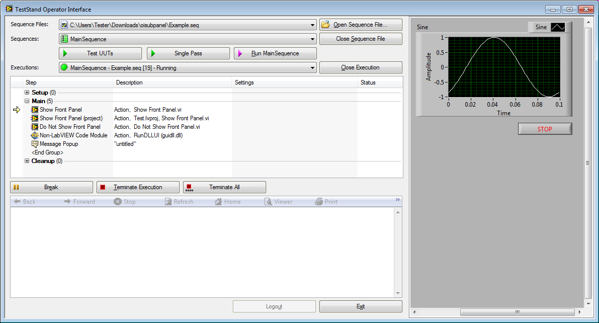

 The visibility of LabVIEW code modules in a TestStand sequence is largely dictated by the "Show VI Front Panel When Called" option in the Step Settings pane. Even then, with this selection enabled, the called VI displays in its own window. This example shows how VI code module front panels can be embedded into the TestStand user interface.
Description
In LabVIEW, a subpanel control can be used to show the front panel of a VI within another VI. If a subpanel is included on the front panel of a user interface, we can populate it with the presently executing code module so long as it is indeed a LabVIEW VI.  This example illustrates how to display the front panel of a VI when the necessary conditions are met:
  • the step calls a VI code module
  • the step is configured to display the front panel of the module
The example uses the trace UI Message to notify the User interface before each step executes.  When notified, an event callback VI determines whether the next code module is a LabVIEW VI and if it has "Show VI Front Panel When Called" enabled.  if these conditions are met, the User Interface populates the subpanel with a reference to the code module VI.
The callback also checks if the VI is loaded in the context of a LabVIEW project, and loads the soccesponding application reference, so thta the proper instance of the VI is displayed in the sub panel.

  1. Execute the TestExec.exe file in the attached archive, or load the build script project, then open the top level VI.
  2. Ensure that the adapter is configured correctly in the sequence editor by selecting Configure » Adapter, then selecting the LabVIEW adapter.  If you are running the UI in the development system, use the LabVIEW development system setting for the LabVIEW adapter.   If you are running the UI as an executable, use the LabVIEW runtime engine setting for the LabVIEW adapter.
  3. open the Example.seq file in the user interface, and run it.  Observe that the LabVIEW modules are displayed in the subpanel.
