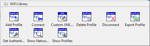

This library provides some often used funcionalities for WiFi.
Screenshot LibraryScreenshot Library
Description
The following functions of netsh (network shell) have been implemented:
1. Add Profile - Adds a WLAN profile to the specified interface on the computer.
2. Connect - Connects to a wireless network by using the specified parameter.
3. Custom XML Write - Writes XML files without the <LVData> header.
4. Delete Profile - Removes a WLAN profile from one or multiple interfaces.
5. Disconnect - Disconnects the specified interface from a wireless network.
6. Export Profile - Saves WLAN profiles as XML files to the specified location.
7. Get Authentication Encryption - Returns the authentication and encryption type.
8. Show Networks - Displays a list of wireless networks that are visible on the computer.
9. Show Profiles - Displays a list of wireless profiles that are configured on the computer.
10. Enjoy WiFi!
Screenshot ExampleScreenshot Example
The library has to be installed using JKI VI Package Manager. Its functions can be accessed in the Function Palettes window under "WiFi Library". The following files are located under the paths:
Toolkit VI's - user.lib\Eric Hayoz\WiFi Library.llb
Example - examples\Eric Hayoz\WiFi Library Example.vi
The separate VI's are included in the zip-file as well.
