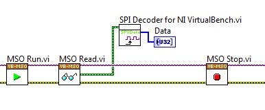

The goal of the VI is to provide a simple way to decode SPI packets acquired by the digital MSO channels of the NI VirtualBench.
It gives the user a similar experience like using the NI VirtualBench Application's built-in feature.
Description
The VI has been optimized for flexibility and thus regenerates all data in the waveform. For a more resource-usage optimized implementation simply use the transition information from the digital data.
The SPI Test Example VI provides a simple way to test the decoder.
- Create a common acquisition application with the NI VirtualBench MSO API
- Connect the SPI Decoder for NI VirtualBench VI to the NI VB MSO Read VI's digital output.
- Select appropriate digital channels and SPI Mode
