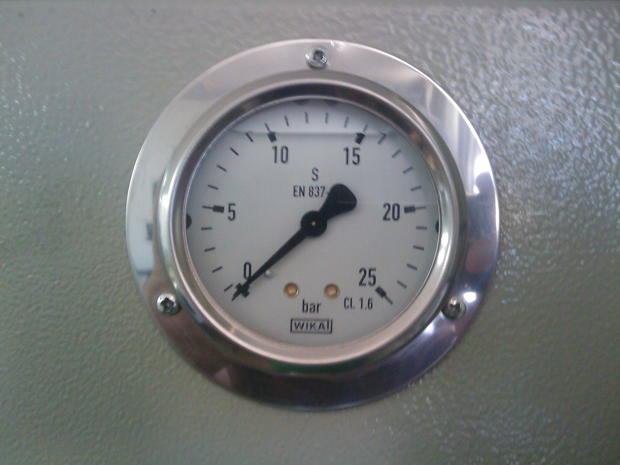

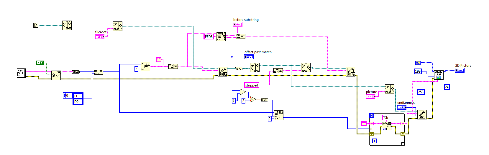

JSResearch
Member
Member
修改时间
Cosmin, I've tried using your code with this image, but it crashes LabView every single time.  Do you have any idea what I'm doing wrong? I've also added a shot of my block diagram.
