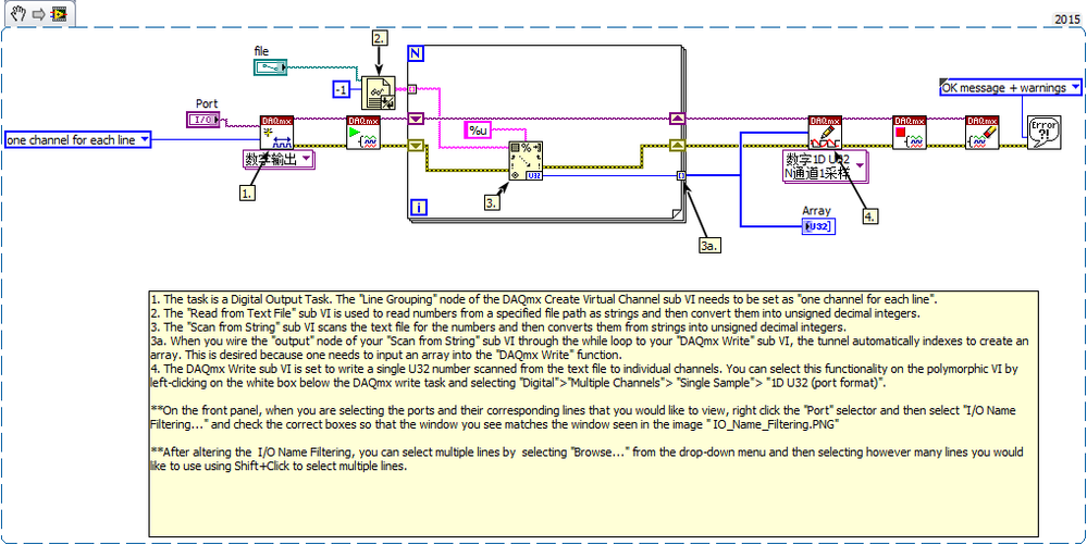

Demonstrates how to scan strings from a text file and write them to various lines of a port.
Description
Here is simple example description:
This is the example that the device can scan the string from the text file and convert them to binaries, which send to the hardware devices. The devices’ digital port can response based on the data message.
Requirements
  1. LabVIEW 2013 (or compatible)
  1. Select the related file path.
  2. Configure the hardware parameters, like Port.
  3. Display the result by array control or hardware indicator lights.
  4. Close the session
VI Snippet
