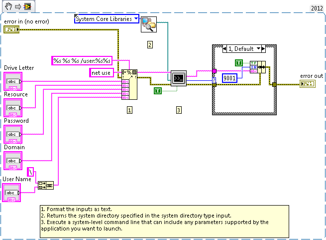

The example VIs show how to map and disconnect network drive.
Description
You can use these two VIs map or disconnect network drive in LabVIEW.
Requirements
  • LabVIEW 2012 (or compatible)
1.Write the IP in Resource Control, write domain, user name, user name,password and drive letter in the controls.
2.Run the VI.
VI Snippet
