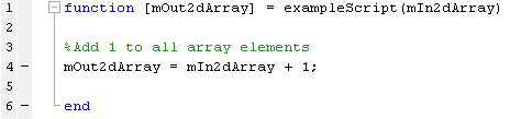

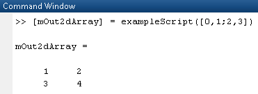

The attached walkthrough has you create a simple MATLAB function that takes in an array and increments all elements in it by 1.

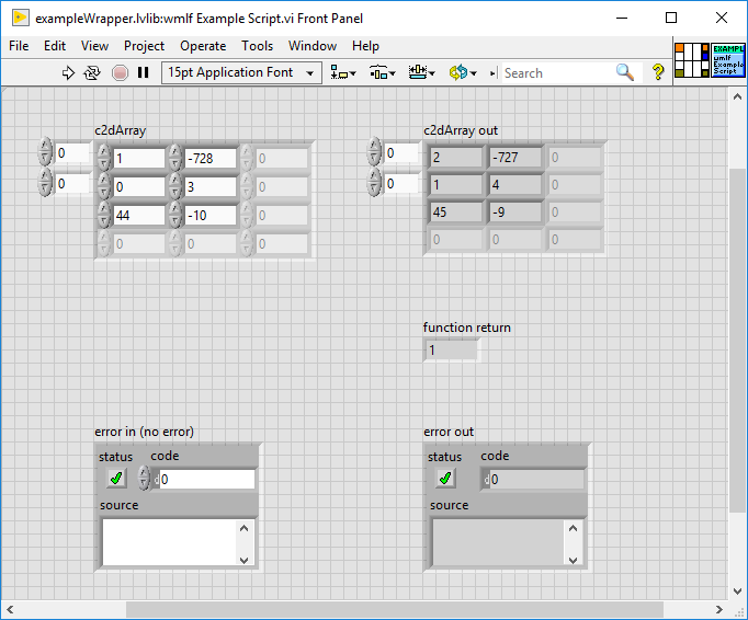

It then covers how to build this function into a DLL you can then call in LabVIEW.
