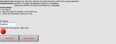

The example demonstrates how to check the network connection between a host and a target application.
Description
If you build a system that involves multiple targets that are connected with a network connection, it is imperative that you can monitor the network connection. If the status of the network connection is not monitored, it is hard to know if no message is received because there was no need for communication or if the message could just not have been received because of problems with the network connection.

  1. Open the attached file
  2. Run the VI
  3. Stop the target to simulate a connection loss
  4. Watch the connection status go to red
Check Network Connection with Network Streams - Front Panel.pngCheck Network Connection with Network Streams - Front Panel.png
Check Network Connection with Network Streams - Block Diagram.pngCheck Network Connection with Network Streams - Block Diagram.png
