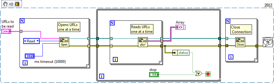

This example shows a way to read/update multiple tags (200+) from your PLC without losing data.
Description
Architect your code in such a way that you can read/update multiple tags (200+) from your PLC without losing data.
Requirements
LabVIEW 2012 (or compatible)
1. Specify the URLs which identify the data sources to read.
2. Run the VI.
