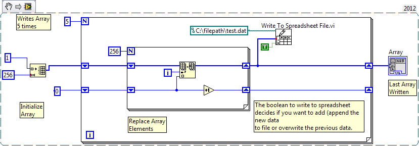

This example demonstrates how to initialize an array, iterate through individual array indexes, and write to spreadsheet file.
Description
This program creates an array of U16 integer values (1-256), writes the array to spreadsheet file, then overwrites the array with new values (next 256 values -- 257-512), writes to spreadsheet file again, then overwrites the array with next 256 values (513-768).  Process writes 5 arrays to spreadsheet (.dat) in this manner.
Requirements
  • LabVIEW 2012 (or compatible)
  1. Specify filename and filepath to save .dat or .txt file.
  2. Click 'Run' arrow.
VI Snippet of Block Diagram
