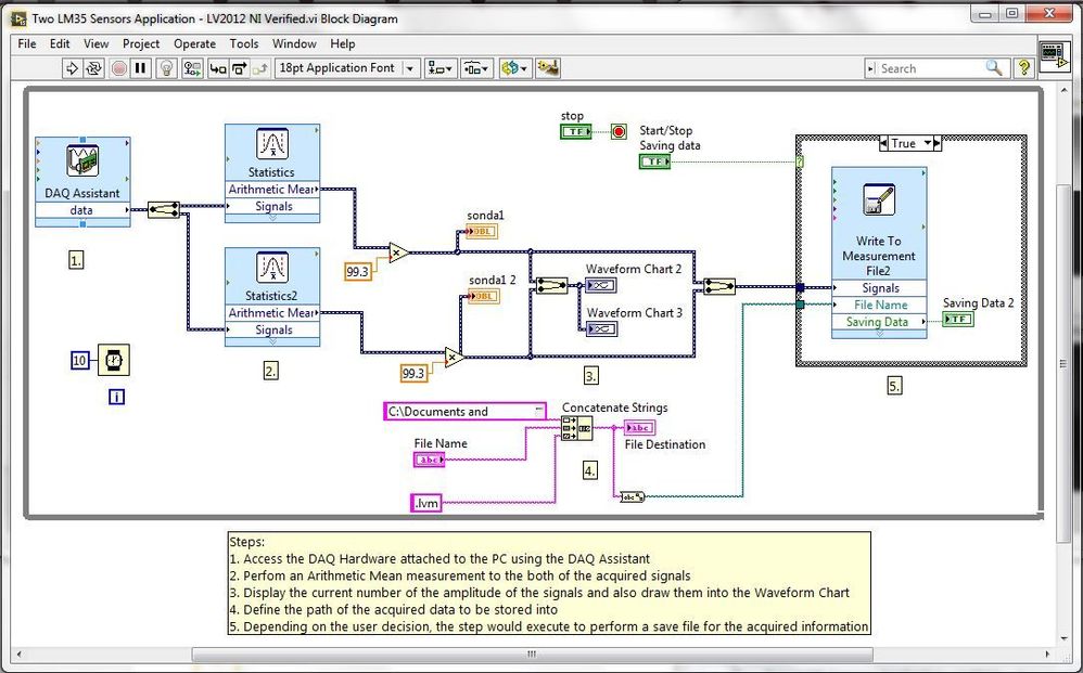

The example demonstrates how to acquire and store the acquisition data from two LM35 sensors with DAQ devices
Description:
Using the DAQmx Virtual Channel, we could access the configuration of using the Analog Input TC function and acquire the value of the temperature's change
Steps to implement or execute code
To implement this example:
  1. Name the File Name and File Destination
  2. Run the VI
  3. (Optional) Turn on the Highlight Execution to see the flow of the VI
Note: Define the Physical channels to be used by accessing the DAQ Assistant on the block diagram
To execute this example:
  1. Install the required software.
  2. Connect the DAQ hardware that supports the Analog Input features
  3. Confirm the connection with the MAX with TestPanel
  4. Open the VI and refer the Implement Steps

Hello
I discovery one solution, the write to measurement file, has a input called "coment" that can be added by a text sring or a text box and it saves the text wen saves the data.
Best regards
