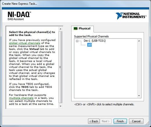

4. Select the USB-TC01 as the measurement device.
Figure 5. Configure the device and channel to measure.
