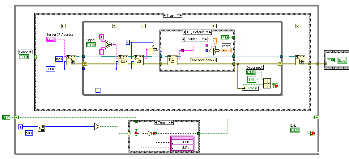

ARM Client
1. Connect the second MCB2300 to the the PC. This board should have a network cable connected to a swtich. The network should have a DHCP server.
2. Modify project settings for the TCP Client - ARM application:
a. Navigate to Communication Options
b. Get the MAC ID or physical address of your computer. (Run "ipconfig /all" and copy "Physical address")
c. Increment your physical address by 1 and enter it in the MAC address field. eg: if you PC is  00-22-19-21-16-27, enter  00:22:19:21:16:28 (note change "-" to ":")
3. Open the Front Panel of TCP Data Client ARM2ARM.vi and enter the Server IP found for the other MCB2300. Make this value the default value (right-click>>Data Operations>>Make Current Value Default)
4. Run the VI and connect.
*Caution* By default, the MCB2300 devices are configured to have the same MAC Address. This will cause a DHCP server assign the devices the same IP Address. The MAC address is configured in the project and steps to change one of them is listed above.
