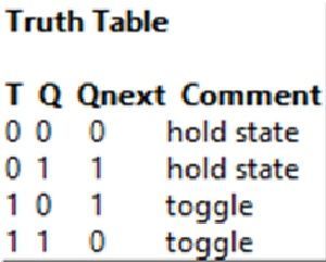

This VI simulates the functionality of T-Type Flip Flop
Description
Flip-Flops and latches are used as data storage elements. A Flip-Flop stores a single bit of data;one of its two states represents a "1" and the other represents a "0". Such data storage can be used for storage of state. T-Type Flip-Flop is a type also known as “Toggle Flip-Flop”. We provide only one input to the Flip-Flop called Toggle input (T). Then the Flip-Flop acts as a Toggle switch. Toggling means changing the next state output to complement of the present state output.
If Toggle is high, the T Flip-Flop changes state (“toggles”) whenever the clock input is strobed. If the Toggle is low, the T Flip-Flop holds the previous state value.

  1. Run the VI
  2. Click Clock to go to the next state
  3. If Toggle is high, the next state changes. If Toggle is low, the state remains the same
  4. To stop the VI, click the Stop button
VI Block DiagramT-Type Flip-Flop LV2012 NI Verified BD.jpgT-Type Flip-Flop LV2012 NI Verified BD.jpg
T-Type Flip-Flop LV2012 NI Verified Truth Table.jpgT-Type Flip-Flop LV2012 NI Verified Truth Table.jpg
