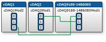

Daisy Chain
When the master chassis is connected to slave 1 and slave 1 is connected to slave 2 in a Daisy-Chain configuration.
Figure 2: NI 9469 Daisy Chain Configuration Example
For the above diagram, cDAQ1 is the master chassis connected to cDAQ9188 (slave 1). cDAQ9188 is connected to cDAQ2 (slave 2).
When using the attached examples with a daisy-chain configuration make sure the first Analog task is the master, the second task slave 1, and the third task slave 2.

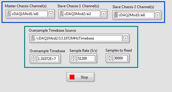

Notes on Attached Example Code
The attached examples are for Delta Sigma C Series Modules and SAR ADCs / Slow Sampled Modules.*  The SAR ADCs / Slow Sampled modules can be used in Star or Daisy-Chain configurations.  The Delta Sigma Modules can only be used in a Star configuration with NI-DAQmx 9.6.  NI-DAQmx 9.6.1 and later versions add support for Daisy-Chain configurations with Delta Sigma Modules.
Figure 3: Front panel of the attached NI 9469 Delta Sigma Modules example VI.
For more information regarding which C Series modules are Delta Sigma Devices, see the C Series Device Groupings topic in the NI-DAQmx Help.  Note that modules with 16-bit Simultaneous SAR ADCs are not listed (ie: 9215, 9222, 9223).  Other modules with SAR ADCs are listed under Scanned Devices
