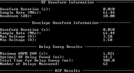

When using the PXIe-5646R and PXIe-5451 in envelope tracking mode, a very precise delay between the two instruments is required to achieve peak efficiency and performance out of a power amplifier (PA). This example allows the user to sweep a range of delays and perform an AMPM measurement at each delay in order to find the optimal delay required for further testing of RF performance.
Note: For an equivalent LabVIEW example, please refer to this link: Sweep Delay between PXIe-5646R and PXIe-5451 in Envelope Tracking Mode for RFIC PA Test (LabVIEW)
Description
 Use this solution as reference on how to set up a fast delay sweep with an RFmx AMPM measurement at each configured delay. There are two methods proposed:
  1. Fine Sweep Only: Sweep from (Initial Delay Estimate - Sweep Range) to (Initial Delay Estimate + Sweep Range) in (Sweep Step) steps
  2. Coarse + Fine Sweep: Perform a coarse sweep to determine a first estimate of the optimal delay. Then perform a smaller sweep with the defined Sweep Step size around the first estimate to find the optimal delay. This method requires fewer steps and is usually faster.
After finishing with the delay sweep, the example will select the optimal delay and perform a RFmx ACP measurement to analyze the DUT's RF ouput performance. Note that many DUT-specific settings are required to be configured before running the example.

  1. Unzip and open the Solution RFICExampleET+DelaySweep+ACP.sln
  2. Configure the RFSG, ARB and tracker parameters in the InitializeParameters() function to reflect the hardware setup used.
  3. Configure the RFmx ACP measurement in the in the InitializeParameters() function. Note that the default measurement is configured for an LTE 10MHz waveform (with 2 UTRA and 1 E-UTRA offsets)
  4. Configure the sweep parameters in the InitializeParameters() function. Make sure to select an appropriate initial delay estimate. You can also configure the AMPM measurement.
  5. Run the VI
    1. In Fine Sweep Mode, you should see the AMPM sweep results in the console:dotNET_FineSweep.png
    2. In Coarse + Fine Sweep Mode, you should see the AMPM sweep results in the console:dotNET_CoarseAndFineSweep.png
