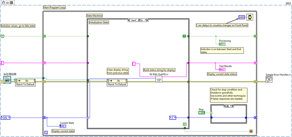

In some applications there may be a need to display data from different states of the state machine. For example, the data or indication of a successful test that was performed. If there are many such tests, then this could possibly lead to excessive Front Panel indicators. This method builds a string to display many different items from different state transitions in one convenient string display.
Description
This program uses a simple state machine architecture. A sub VI is used to build the string and each state can call upon this sub VI to update the string record. That record is stored by passing it through a shift register on each iteration. The program is fairly modular and can be easily modified by changing the sub VI or the typedef control used for the states.

  4. The program will stay idle until the Start button is pressed. While iterating through different states, the Processing light will be on and the Test Results indicator will be updating with the string data. After completion, it will default back to idle.
  5. Press the Stop button at any time for a safe shutdown (keep in mind that this is not event driven programming)

VI Snippet of Block Diagram
