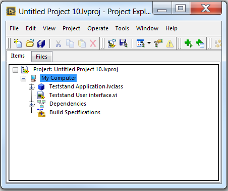

Click next, under project root browse to a path where you want to save your project. Once you are done, click Finish. Subsequently your new project opens which already contains a top level vi (Teststand User interface.vi) as well as your Teststand child class (Teststand Application.lvclass😞

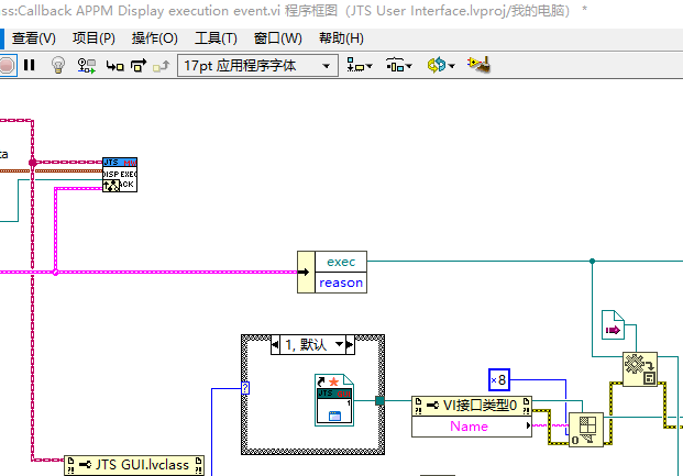

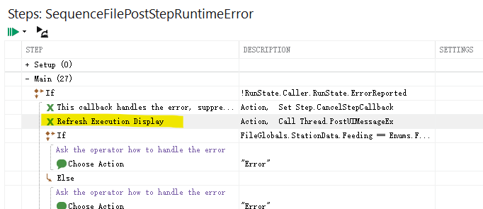

JasonBro
Member
Member
on
Thank you very much for your contribution.
I encountered a problem during use:
When the test encounters a run time error, the ExecutionView Manager will become gray and cannot display the normal sequence.
I added "SequenceFilePostStepRuntimeError" to my sequence, but it still had no effect.
My guess is that it needs to be displayed in the callback "". But this is used to start a new execution.SequenceFilePostStepRuntimeError.pngDisplay execution event.png
