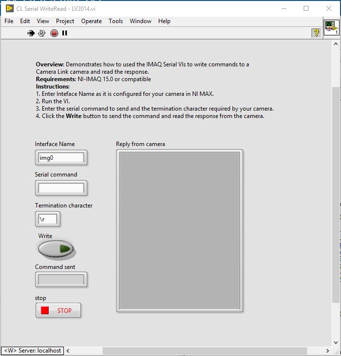

 Use this example to send serial commands to a Camera Link camera and read back the response.
Description
All Camera Link cameras use an RS-232 port for configuring settings. This port does not enumerate as a normal COM port in your computer, but you can use IMAQ Serial Write.vi and IMAQ Serial Read.vi to send commands to your camera that is connected to an NI Camera Link frame grabber. This example performs a simple write and read allowing you to communicate with your camera in order to set attributes that are not available in NI MAX.
Hardware and Software Requirements
LabVIEW 2014 or later
NI-IMAQ 15.0 or later (included in Vision Acquisition Software)
Camera Link camera
  1. Download and open CL Serial WriteRead - LV2014.vi.
  2. Ensure that your camera is recognized and configured in NI MAX with the correct serial settings.
  3. Enter the Interface Name as it is configured for your camera in NI MAX.
  4. Enter the serial command that you want to send and the termination character(s) required by your camera.
  5. Click Write to send the command and read the response from the camera.
Front Panel:

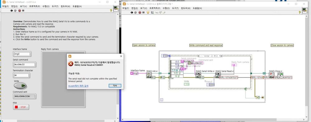

Hi!
I want to communicate with the serial port on a camera link camera (Ninox 640 SU by Raptor Photonics).
As the two attached pictures show, I cannot communicate by using CLwriteread.vi although it works fine when I use the test serial settings in camera file generator.
Could anybody explain the reason?
Best regards
Choi
