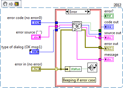

This example demonstrates how to add a beep in case of an error in the VI.
Description
In LabVIEW you are able to generate sounds based on conditions that can be triggered programmatically. This VI takes the functionality of the Simple Error Handler provided in LabVIEW and adds a system beep when an error occurs. It has all of the same inputs/outputs as the Simple Error Handler, but it adds the beep.
Requirements
  • LabVIEW 2012 (or compatible)
  1. Download the attached files to your computer
  2. Open the VI "Simple Error Handler with Beep LV2012 NI Verified.vi"
  3. Select an error code, the status and the source
  4. Run the VI
  5. Hear the beep
