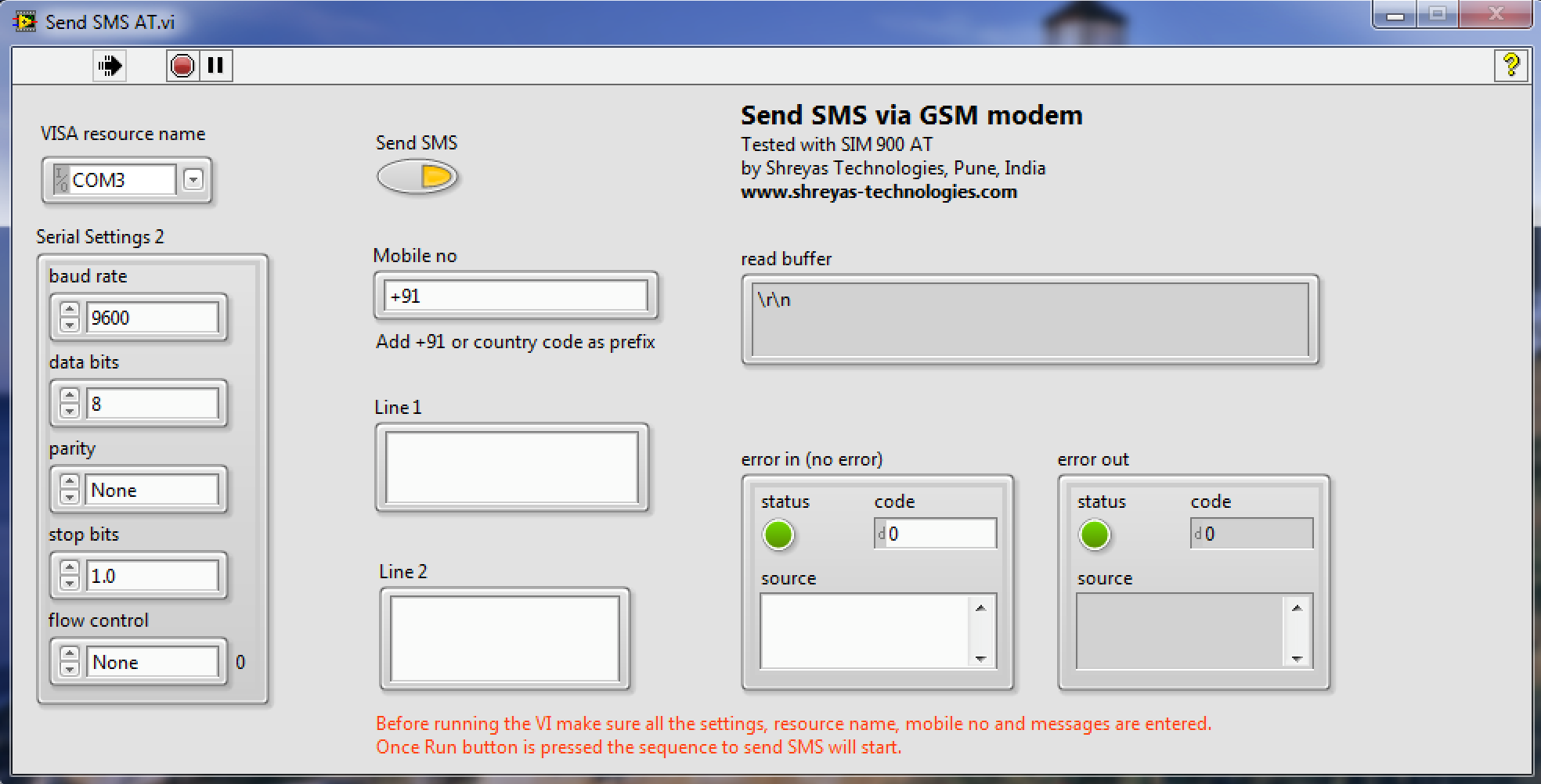

This VI send SMS using LabVIEW and a GSM modem like SIM900 AT or any other such modem
Description
Developed by Shreyas Technologies, India
For any additional functions like recieve SMS, make calls or recieve calls, etc contact us. This VI is easy to use , drag and drop with proper documentation and testing.
  1. Unzip the rar file
  2. Install necessary drivers for your serial hardware and converters if any
  3. Insert an activated SIM card in the module and power on the device.
  4. Test the module by hyperterminal, putty or VISA test panel
  5. Once verfied and proper baud settings are set on the port, open the Send SMS AT.vi
  6. Enetr the port settings, mobile number and the mesage to be sent. Turn on the send SMS button.
  7. Run the VI. It should take not more than half a minute to send the SMS
  8. Once done, a popup will notify you if sent sucessfully or not.
  9. You may drag and drop this VI on you block diagram. The necessary teminals have been set. Just wire in the data, and there you go!
