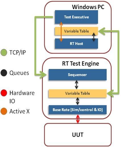

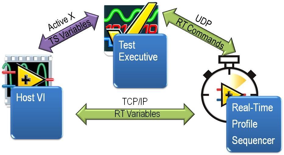

The Real-Time Test reference design consists of three high level components. The RTT Engine component executes the RT test profiles by generating different stimuli and analyzing the DUT’s response. The test executive component is responsible for automating the test, analyzing the results, and displaying a comprehensive report to the operator. The host component is used to monitor variables as well as to access and display parameters and signals as the test is performed.
The communication between the three subsystems occurs via TCP/IP, UDP or Active X, depending on which two systems are communicating. The following diagram shows the communication channel used and what type of data is being passed.
RT Test Engine
The purpose of the RT Test Engine is to deterministically execute the test profile used to verify the functionality of the DUT. The Real-Time Test Engine can be broken into smaller sub components according to their specific function. These smaller sub components are a host communication server, an application command server, a real-time profile sequencer, a data logger, a command dispatcher and a base rate loop. These sub components will be discussed below.
Each sub component is a queued state machine. This allows the test executive to send commands to each process loop within the RTT Engine and control their tasks. Examples of these commands are start, stop, pause, abort, configure, etc. The commands sent by the test executive are received by a dispatcher and then assigned to the correct process through queues. These queued state machines are built on top of the Asynchronous Messaging Communication (AMC) reference library.
The AMC library will be installed as part of this Real-Time Reference Design. To learn more about the AMC, review the link at the end of this document to: Asynchronous Messaging Communication (AMC) Reference Library.
The following diagram shows how the different components interact with each other.

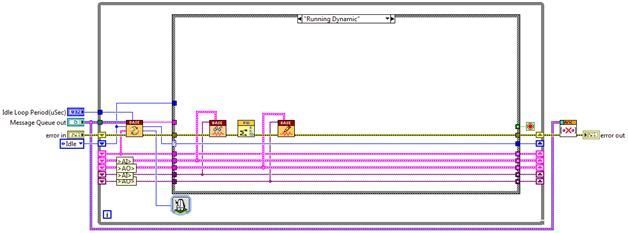

Base Rate Loop
The base rate loop runs the dynamic portion of the system. This loop consists of two pieces: the IO Scan Engine and the Control/Simulation loop.
Since this loop is responsible for timing the real-time test, this loop executes the IO Scan blocks and the dynamic block
RT IO Scan
The IO Scan component is responsible for reading the physical response from the DUT, updating the variable table, and vice versa by writing the new stimulus value to the hardware.
Control/Simulation
Depending on the type of real-time test that needs to be done, this control/simulation piece can be developed in different ways. For example, in the hardware in the loop (HIL) or rapid control prototyping (RCP) case, the system model can be generated using LabVIEW Simulation or LabVIEW SIT. If it is an engine test scenario, then the LabVIEW Control Design toolkit can be used to implement the control algorithm. Sometimes the RT Profile Sequencer Loop can replace this block altogether.
These two pieces operate in the following order. First, hardware inputs are read and the variable table is updated with the new values. Then, the base rate loop runs one step of the control or simulation algorithm. Last, the hardware outputs are updated. All this occurs within one iteration of the base rate loop.

Test Executive
The test executive is the part of the architecture that is responsible for automating and managing the entire test or tests by sending the commands to the RTT Engine to configure, run, stop, etc. the different components in the RT system. It is also responsible for deploying test profile sequences, analyzing results and generating reports.
The test executive uses a set of VIs that function as an API to send commands to the RTT Engine named RT Command Client VIs. These VIs can be used from a LabVIEW built test executive or from TestStand. These VIs are implemented using the ACM library. For more information on the ACM library review the document linked at the end of this document.

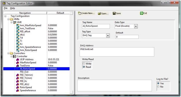

Variable Configuration Editor
This tool is used to create and configure the variables that will be used in the system as well as to bind local variables to remote variables. The configuration is stored as an XML file which needs to be transferred via FTP to the RT controller’s root directory where it is parsed by the RTT Engine.

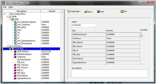

The Test System is broken down into two main subsystems, which are: Host (HMI) and RT Controller (Controller)
Variables that run in the Windows computer are configured under the HMI section. The Host supports two types of variables: Local Variables and the Network Variables. The Local Variables are CVT variables that are used locally on the Host. Network Variables are CVT variables that are used on the local Host VI but also write or read from variables running in the RT Controller (RTT Engine).
Variables that run in the RTT Engine are configured under the Controller section. The controller supports two types of variables, although it could be expanded to more. The first type is Local Variables. Just like the local variables on the HMI, these variables are used in the local system. The second type of variable is the IO Variables. These are the variables that store the data values for any IO channel configured for the test. The IO variables are mapped to hardware I/O by specifying the address to that channel. The hardware address can be obtained from Measurement & Automation Explorer (MAX).
The following image shows how a DAQ Variable is linked to the AI channel 0 under slot 8 of a PXI system.
To learn more about how the Variable Configuration Editor is implemented, go the link under References for Generic Configuration Editor.
Located at: tce_source_201(DAQ)\TCE Source\TCE
Open the TagConfig.lvproj project and run the TagEditor.vi. The sample configuration file used in this application is located at \RTT Reference Design\TCE files\TCE_ConfigPID.xml.
This configuration file contains the variables used by the example application. To run this example, the binding to the hardware variables and the IP address of the Host computer need to be modified to your setup. To do this go to the UI IP Address variable and update its value to your computer IP Address. Then go to the AI_RotorSpeed and PID_Out variables and replace the address to match your hardware. For example:
The PID_Out variable has as address PXI1Slot8/ao0
Once you have updated the hardware variables and the UI IP Address variable, save the file and transfer it to the root directory of your RT controller via FTP.

Base Rate Loop
This process is responsible for performing the hardware inputs and outputs. This loop waits for the test executive to specify the path to the hardware configuration file that it is used to configure the hardware. Once configured, the base rate loop waits for a command from the test executive to start running. Because this process is a state machine, it can be interrupted by the test executive at any time to update hardware configuration, stop IO, etc.
Once started, the base rate loop reads from the hardware and updates the variable table. Then it executes the dynamic system (PID control in this example) and finally it uses the new variable table values to update the hardware outputs.

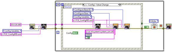

Test Executive
Two different reference applications are attached to this document. The difference between the two applications is that one uses TestStand as the test executive and the other one uses LabVIEW.

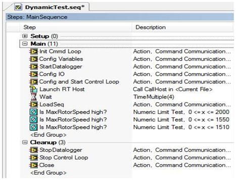

Using TestStand as the Test Executive
To use TestStand as the test executive, open the RTTest.seq sequence file located at \RTT Reference Design. To run this example the only thing that needs to be done is change the IP address under the Init Cmmd Loop Action Step, to match your RT Controller and make sure the RTT Engine is already running.
In this example, TestStand is responsible for opening the session with RTT Engine, sending the test configuration parameters, and sending all process commands.
The sequence first configures the variables that will be used in the test by passing the path to the XML configuration file that was previously created using the Variable Configuration Editor and transferred via FTP to the RT system as part of a command to the RTT Engine. Then, the data logger is started and the base rate is configured. A user interface (discussed below) is opened for the user to view the test. Once this is done, a real-time test profile is deployed to the RTT Engine and then executed by the RT Profile Sequencer.
While the RT test profile is being executed, TestStand waits for the “TestDone” variable to be True. In this application example, the last step in the RT sequence is “Set TestDone to True”. This variable is set by the engine once it gets to this final step. The Host then reads this variable and updates a global variable within TestStand through Active X that awakes it from the wait state and makes it continue with the rest of the TestStand sequence.
Once the RT profile is done, TestStand evaluates the maximum RPMs achieved by the motor, and performs a limit test. TestStand then sends the command to stop the data-logger and disconnects from the RTT Engine.
After that, TestStand generates a report with the value for the variable used in the limit test and the results of the test (I.e.: pass/fail).
Host
The Host VI is located at: RTT Engine and Config\RTT Reference Design and is called RTT-Host(TS).vi. Note: This VI can only be ran when called by TestStand.
As mentioned above, the host VI is launched in a different execution thread as an asynchronous process through a sequence call. It is responsible for displaying the values for the set point and actual motor speed on a graph while the test occurs as well as to set the PID gains.
Once the test is done, this VI reads the TestDone variable from the CVT and writes its value to a global variable within TestStand using Active X. Using this same method it passes the max RPM variable value to TestStand so that TestStand can evaluate this number in a limit test.
