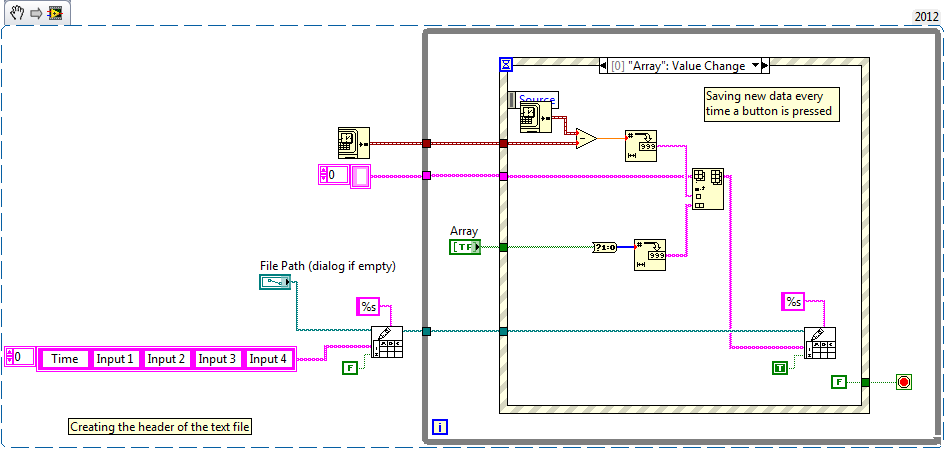

This example VI demonstrates how to This example demonstrates how to register changes in a boolean control on a text file.
Description
This example uses an event structure and high-level file I/O LabVIEW APIs to record when a boolean value is changed while the program is running. At any time when a value is changed the time is recorded as well as the current state of the boolean array. This enables the user to keep track of the value change and to check which values were changed at any time. The data can be saved to a spreadsheet that can be opened with Excel or similar spreadsheet software, such as a text editor.

VI Block Diagram
Record Boolean Change LV2012 NI Verified.pngRecord Boolean Change LV2012 NI Verified.png
