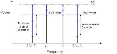

By combining the intermodulation distortion with output power we can design a second specification, third order intercept (TOI). This theoretical specification is the output power at which the distortion products will be equal in amplitude to the two-tone signal of interest. We will see that for every 1 dB increase in the fundamental tones, there is a corresponding 2 dB and 3 dB increase for the second and third order distortion products respectively. This relationship is illustrated in the figure below:

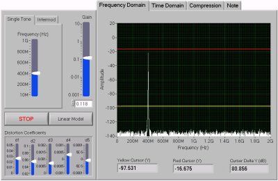

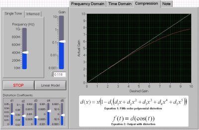

The following demonstration will simulate both a single tone and two-tone intermodulation test. These tests are based on the intermodulation distortion (IM3) and third order intercept (TOI) specifications. It will examine the effect of non-linearity on the system and output signals.
We can conclude that the third order intercept calculation can associate the intermodulation distortion measurement with a particular power level. It is important to keep in mind that this is a purely theoretical analysis since the third order intercept is always greater than the output power of the instrument. It is also important to note that the higher the third order intercept of an instrument, the better. The third order intercept specification is an excellent way to characterize the dynamic range of the target instrument.
