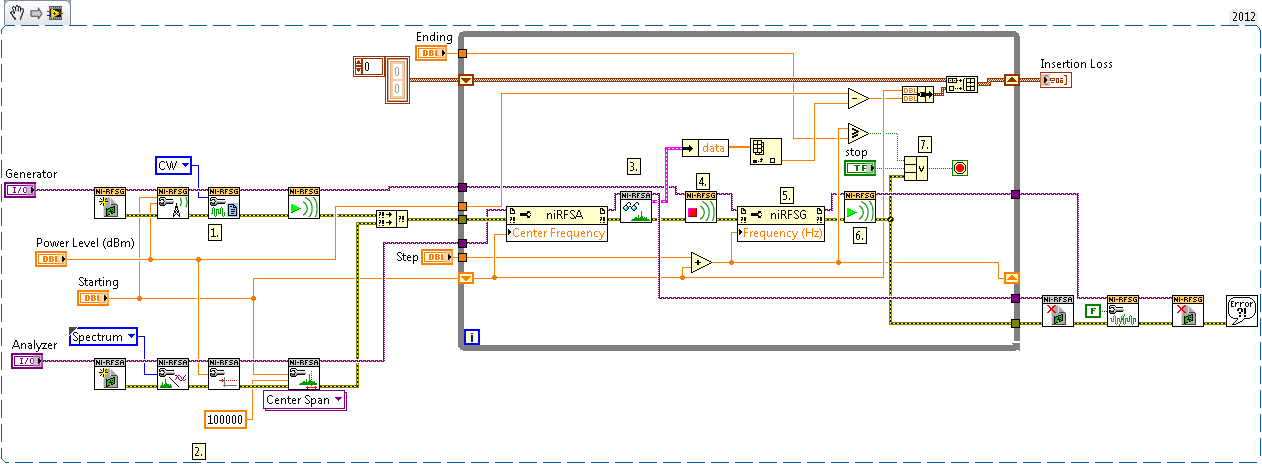

Overview
Coding that exemplifies how to perform a frequency response of filter.
Description
This simple VI is a powerful tool in quickly finding the frequency response of any chip, but is specifically designed for a simple filter. This example uses the RFSG and RFSA drivers.
Requirements
1. LabVIEW 2012 (or compatible)
2. NI RFSA 15.0.2 (or compatible)
3. NI RFSG 15.0.2 (or compatible)
1. Connect your filter between the Vector Signal Generator and the Vector Signal Analyzer.
2. Choose the VSG and VSA on the front panel.
3. Select the range of frequencies you want to test as well as the frequency step you want to take.
4. Run the VI.
