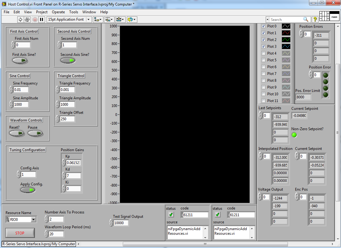

The host provides some very basic functionality for tuning, sending 2-axis trajectories, and comparing your success/debugging problems.
The top left pane provides an interface to any two of the four axis that the FPGA is capable of controlling. You can send a test Sine signal, test Triangle wave, or modify the code to send arbitrary points. You can reset or pause the waveform (although you should be careful not to exceed your maximum position error when resetting).
The tuning configuration is provided so axis can be tuned independently. It is recommended you perform your tuning on slow moving signals before increasing the signal frequency.
The general configuration is provided at the bottom of the VI. The R Series resource, number of axis the FPGA should process, host to target send rate, and analog voltage test signal (for debugging or triggering) are configurable. The Waveform Loop Period controls the rate the host sends points to the target. It is highly recommended that this interval is decreased for higher frequency signals.
Errors on both the primary loops in the code are displays (although warnings are typical, errors will stop the VI).
The right side shows raw debug information from controls on the FPGA. Every stage of the data pipeline is represented, from the requested setpoints, to the interpolated position, to the actual setpoints, voltages, encoder positions, and position errors.
Finally, the graph in the middle shows the signals being sent in comparison to the encoder feedback pulled from the lossy FPGA indicators. In order to make this lossless, a FIFO is provided (although not implemented on the host) which will sent encoder points at an interval the user may configure.

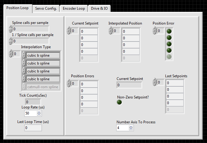

The position tab has some of the primary control options and debug information. The Number of Axis to Process allows the user to limit the work the FPGA must do to control multiple axis. If the user only wants to axis, they can prevent the FPGA from needlessly processing the other two axis splines and PID functions (which are very resource intensive).
It is recommended that the loop rate be 50us and the spline calls per sample be around 100. These should be set from the host.

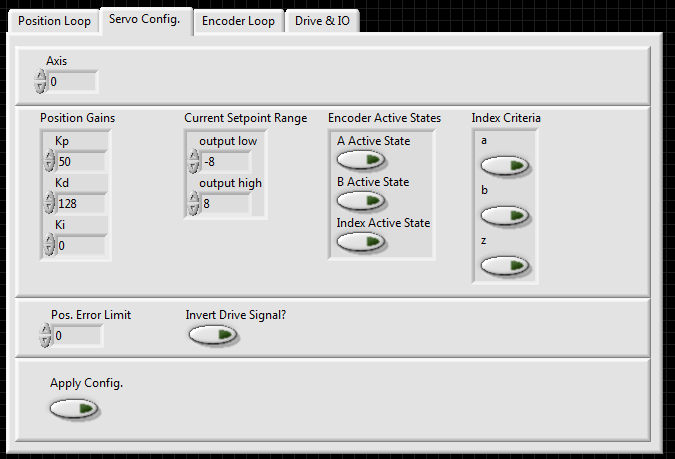

The configuration screen is provided for setting range and PID Gain information. It is highly recommended the these values be carefully configured before activating the FPGA.

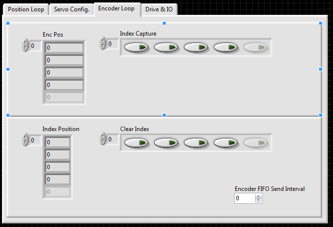

The encoder values may be read via the Enc Pos indicator for lossy communication. However, a FIFO is provided (and updated every Encoder FIFO Send Interval iterations) for lossless testing. This is increasingly useful the faster your loop rate is.

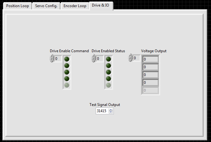

The drive IO section provides very basic enable and status information, voltage outputs, and a test analog output channel which are updated in the position loop.

The loops below the position loop should never need to be modified. They are responsible for updating the encoder position, configuration, and various other variables.
