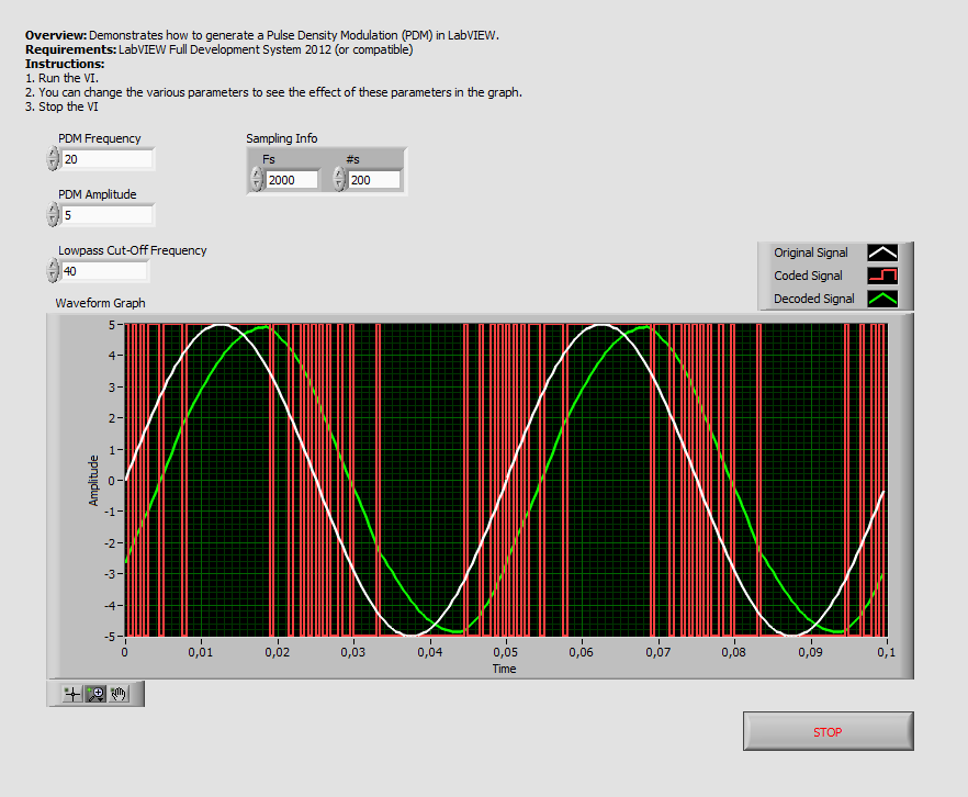

This example demonstrates how to generate a Pulse Density Modulation (PDM) in LabVIEW.
Description
Pulse Density Modulation, or PDM, is a form of modulation used to represent an analog signal in the digital domain. In a PDM signal, specific amplitud values are not encoded into pulses as they would be in PCM. Instead it is the relative density of the pulses that corresponds to the analog signal's amplitude.
This VI simulates an analog signal, modulates it using PDM and restores it to an analog signal.

  1. Download and open the attached VI
  2. Run the program

Hello BeCeGa, I am new to PDM stuff. I am trying to undersatnd how this sine wave will be represented as 1 bit . It's so confuding for me. can you help me understand this concept. For example If I have sine wave of +/- 5 Amp and If I sample at 10K Hz I have N number of sample now with different amplitute range so how do we represent these different amplitudes in 1 and 0 as 1 bit PDm signal. Anyhelp is appreciable.
