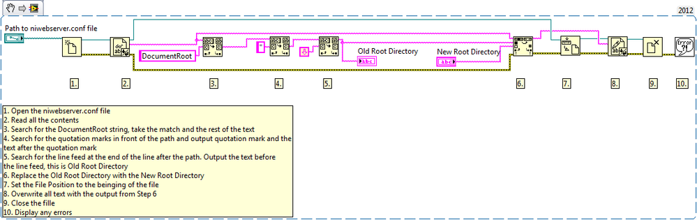

Use this VI to programmatically change the Web Server Root Directory that is normally changed from the LabVIEW Options window.
Description
This program shows how one could programmatically change the Web Server Root Directory that is normally changed from the LabVIEW Options window.
Ensure that the program has finished writing to the file and that the file is closed without error before doing anything with LabVIEW Web Services (Remote Front Panels, etc.).
Requirements
  • LabVIEW 2012 (or compatible)
1.Select niwebserver.conf file
2. Insert the new root directory
3. Run VI
Block Diagram
 Change web server path LV2012 NI verified.pngChange web server path LV2012 NI verified.png
