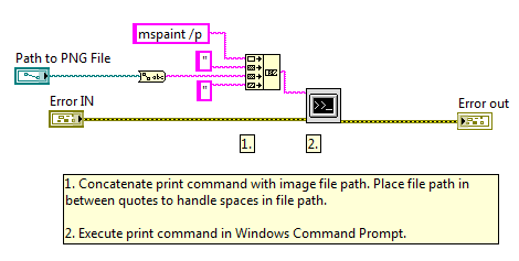

This VI programmatically calls Microsoft paint to print a PNG file to your default printer.
Description
This VI use System Exec VI to call Microsoft paint and print a PNG file to your default printer.

  1. Download the attached VI and PNG File.
  2. Enter the correct paths of the .png file you just downloaded.
  3. Run "Print Image from Microsoft Paint 2012 NI Verified.vi"
  4. Enter the path to the print image you wish to save.
VI Block Diagram
